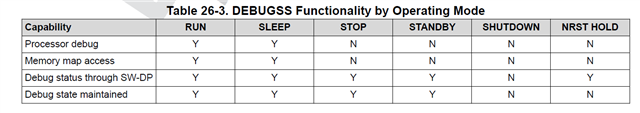

I use runsleep0 power mode, then all is fine with debugger, and also fine if I use the part out of debugger
By fine I mean that CAN frames are sent, then it goes to sleep, then out of sleep, and CAN frames are sent

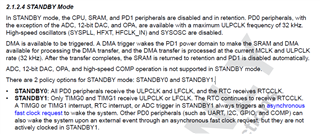

To reduce power I change to standby instead of sleep, with debugger all is fine, but out of the debugger, after the first time standby is entered, then no CAN frames are sent

                  //DL_SYSCTL_setPowerPolicySTANDBY0(); //TBR 23/05/2023! due to bug in early samples, it doesn't work

                  //DL_SYSCTL_setPowerPolicySTOP0(); //for flash mode only - stop 0 still can works but not in stop 2
                  //DL_SYSCTL_setPowerPolicySTANDBY1();//for flash mode only- no can in standby 1, in standby 0 same

Only difference I saw from early samples (as this code was created at that time) is that timer 1 is on TMA0 as there is no TIMG1 available from sysconfig now
Could it be the issue?
