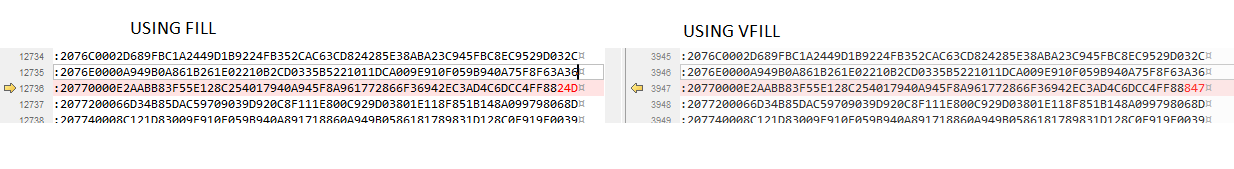

While debugging the error we tried changing VFILL to FILL in the linker file for the flash memory sections.  We noticed that when using FILL the error didn't occur.  Using FILL is less convenient as it results in a much larger HEX file size that will be more time consuming to flash.  We compared the HEX files produced with using VFILL and FILL and noticed that there was a difference on the ECC calculated, which I think is incorrect.
This is a screenshot of the ECC codes for a specific section of memory (note that this screenshot is for a different binary from the one used to get the CCS screenshot):
ECC Screenshot
The following is a screenshot of the flash data for that ECC:
On the data side, it seems that when using VFILL zeroes are used for empty memory. When using FILL, FF is used instead.  This doesn't seem to be the reason for the ECC difference as the other ECC codes do match.
What could cause a difference in the ECC calculated using FILL vs VFILL?

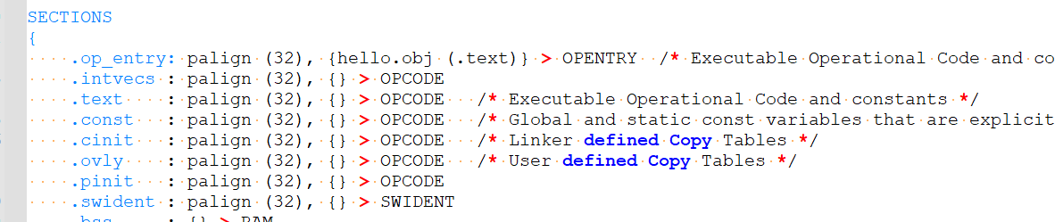

  • Hello Jagadish,
    We had previously looked at the link you provided and it is not a good solution for our case.  Our linker command file does follow all recommendations from that topic, we are using "palign" in our sections:
    Thanks!

    What you are referring to may be a different type of issue.  The issue we are seeing is that the HEX file generated (not flashed) has different ECC depending on if VFILL or FILL is used, would Uniflash somehow affect this?
    Thanks!
  • Hi Jose,
    Both FILL and VFILL should fill the flash hole with 0xFFFFFFFF if the fill-pattern is 0xFFFFFFFF.
    The ECC value in your HEX is correct for FILL case and VFILL case.
    For FILL:
    The data is at 0x3B8F8: 0x 23800001, and 0x000000FF,  --> I got flash address based on your ECC addr offset 0x771F*8 = 0x3B8F8)
    The ECC should be 0x82  (my calculation using ECC table in TRM)
    For VFILL:
    The data is at 0x3B8F8: 0x 23800001, and 0x00000000,
    The ECC should be 0x88 (my calculation using ECC table in TRM)
    The code using VFILL and FILL didn't have any modifications.  The 0xFF in the data was added by the linker when using FILL.
    Shouldn't the ECC code be calculated the same way, using 0xFF when using VFILL even if the data is 0x00?.  The fill pattern (when using either FILL or VFILL) is the same 0xFFFFFFFF.

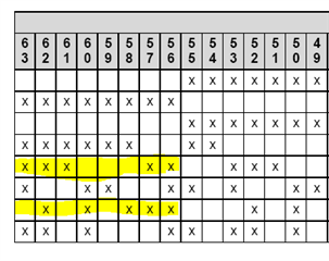

  • Hi Jose,
    For the ECC calculation, the data is aligned a 64-bit boundary (address 0x0~0x07, or 0x8~0xF). The 0xFF (FILL) and 0x00 (VFILL) are used in the ECC calculation as the upper byte (address offset 0xF).
    Same way is used to calculate the ECC. Please refer to the Table 5-1 in TRM: ECC Encoding for BE32 Devices
    Each ECC[x] bit represents the XOR of all the address and data bits marked with x in the same row. For upper data byte (bit 63~56) 0xFF and 0x00, the ECC difference is at ECC bit 3 and ECC bit 1 (odd number of x): 0x82 vs 0x88
    Both ECC values are correct.

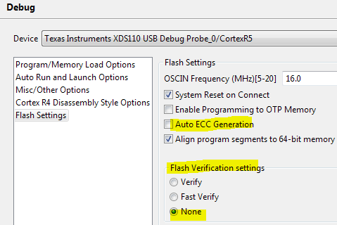

  • If you use linker to generate ECC for your project, it is necessary to change the loader settings so that the loader doesn’t try to generate ECC. Flash verification during programming needs to be skipped because the data areas and ECC areas will now be programmed in separate steps.
    You can access these settings in “Flash Settings” as shown below and make sure:
    • Auto ECC Generation is unchecked
    • Flash Verification Settings should be ‘None’
    • Perform Blank Check before Program Load must be unchecked
    We had already unselected the "Auto ECC Generation".  When we select "None" in the "Flash Verification Settings" the issue disappears.
    I would assume that since we are not verifying a successful load, there is a small risk that the flash was actually not successful and we wouldn't notice unless we tried to run the software and hit the part that was corrupted.
    You had previously mentioned a bug in Uniflash and an updated DLL.  What version of Uniflash would have the issue resolved?
    Thanks!
