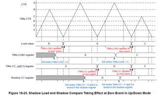

I want to change the duty of PWM every cycle.
So I'm trying to use DMA to write duty to a capture/counter register every cycle.
I use a GEN_EVENT0 as the DMA trigger source.
But my project is not working.

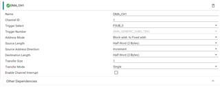

2. DMA setting

  • For the DMA1 is configured to move the data from a buffer to PWM load value, but why do you configure the DMA1 destination address to another buffer as below?
        DL_DMA_setDestAddr(DMA, DMA_CH1_CHAN_ID, (uint32_t) &gPwmReg[0]);
    I think you should move the data to CC register I think.
  • Hi Gary Gao,
    The reason why the DMA destination address is set to buffer is to test the DMA trigger source first. This is not a problem.
    I guess the cause of the problem is the DMA subscriber settings.
    The DL_DMA_setSubscriberChanID function is not automatically included in the file generated by sysconfig.
    I am trying to implement the picture below. And try to write TIMx.LOAD = A with DMA instead of SW.

    Below is the code I simply tested for PWM and DMA operation.
    It seems to work normally, but I don't know if I set it up correctly.

  • Do you do the configuration with sysconfig right? If so and it works, the code should be no problem.
