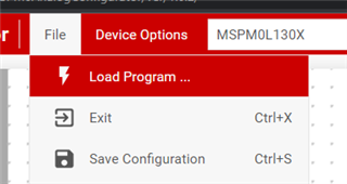

I am trying to use the Analog Configurator with the LP-MSPM0L1306. However, I can't connect the tool with my board.
It keeps showing the message "Error: Loading program for MSPM0G3507 device failed" though I changed the Device options to LP-MSPM0L1306 or MSPM0L130X. Please advise.

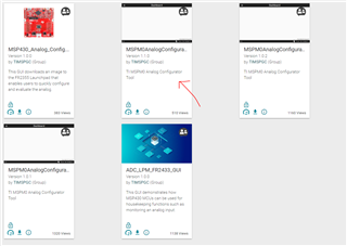

  • Hi Kien,
    First you should download the image as below

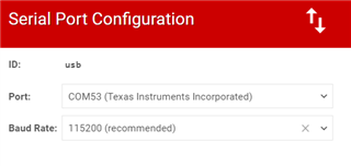

    Then choose UART com port based on your PC.

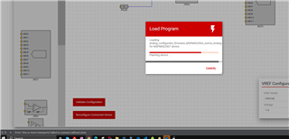

  • Even I do all the steps the "Data" does not receive data.
    When loading on "File - Load Program" the out put states "Error One or more transports failed to connect without error"

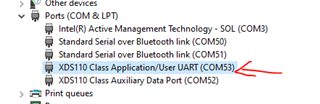

    Device manager
    COM port identified

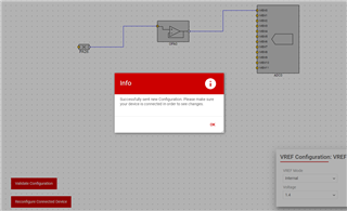

    However, still waiting for data.
    I clicked reconfigure,....
    Do I have to input physical input signal to see "waiting for data ..." to change?

  • Could you share me the picture of the screen of the device? And I try the PG2 device with GUI 1.1.0 and it works(there are three different versions there as below)
  • Hi Gary,
    I am working with Thorsten on this customer issue.
    I also have a Rev A based MSPM0 EVM (part number on package: 24A3K6W G4 XM0G REV A)
    I have tried to connect this board to the different versions of the analog configurator using the exact same steps.
    For 1.1.0 = I end up in "waiting for data", there is no plot for ADC and I dont see the COM connection switch to connected symbol
    For 1.0.2 and 1.0.1 = I do see switch to COM connected symbol and I get continous 0 output as ADC plot
    So I think RevA only works with version 1.0.2 and 1.0.1 of analog configurator ... I did not check with a particular input on the ADC pin though for 100% confirmation.
