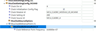

Is it related to McuClockSetting? My MCAN clock setting is as below.
Please let me know how to enhance the performance of CAN ISR.
