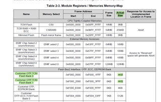

I have programmed a part of customer OTP memory and I have some other space. If ı program about 4kb space one in the customer OTP, I wonder if the remaining other 4KB can be used for TMS570 series?
For example,
Firstly, 4KB of the OTP is programmed by me.
After that, I want to program other 4KB space, Can I do that?
Best Regards!

    First i want to clarify you that the actual customer OTP sector size is just 4KB not 8KB.
    The Frame size specified is the architectural capability of the technology/IP. i.e., the hardware designs can accommodate up to the frame size as noted; however, the actual size is the size truly implemented in the device. So, for this device the actual size for customer OTP is 4KB.
    And in this 4KB you can program any size of the data depending on the requirement and you can resume the programming again after some time as well.
    But just keep below things in the mind:
    1. If you write to program the customer OTP, make sure you do not unintentionally write to the AJSM locations (0xF0000000-0xF000000F) or you will lock the part. You can write data starting at address 0xF0000010.
    2. The size of customer OTP for each flash bank is 4k.
    3. The Customer OTP cannot be erased.
