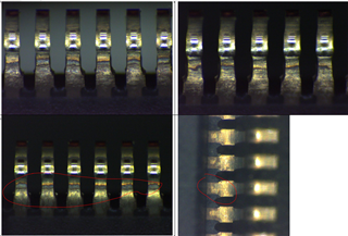

Part Number: TM4C1294NCPDT
Please see below finding,QC concerns are discoloration/oxidation. COO PH, DC 22+
Please advise if these are normal for this part ?

I don't have the expertise to answer if this normal or not. I will need to get some details from you for our team to answer the question. Can you please answer a few questions?
- What is COO PH, DC 22+. Please elaborate what each term means.
- Has this chip in picture soldered on a PCB board at any time? Or this picture is taken before it is ever assembled to the board?
- Is the discoloration on one particular side of pins or all sides of the chip?
- If the chip in picture has been mounted on the pcb, has it been running any program? If yes, for how long?
- Is what you are showing in the picture for one chip or multiple chips?
- Have you seen the same discoloration across all chips or only one chip?
- What type of storage or operating environment (eg. temp, humility) is the chip in the picture subjected to?
Hi Charles, part is assembled in Philippines, date code is 2022+, parts are manufactory sealed, when we opened the package and found various chips with discoloration , on all sides of the chip. parts are not yet used on the PCB. part is under well storage, it was full manufactory package but with discoloration. is it normal ?

Can you confirm one more time that this chip has not been soldered to a PCB yet? It has always been stored in the esd / moisture bag with passing humidity card? In another word, you have seen the discoloration the first time after you opened the package?
Hi Grace,
Talking to our expert, they consider it normal. If you see any issues after soldering on the PCB, please report back. Thanks.
