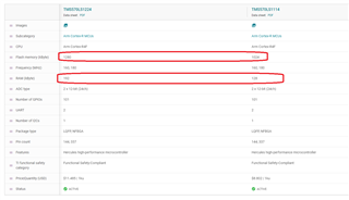

I question myself, what the exact difference between the TMS570LS1114 and 1224 is.
=> As far as I understood, only the flash memory size is different.
So can I assume that any code working on the 1114 will work without any need of change on the 1224 under the assumptiont hat the flash memory size is no problem?
Kind regards and thanks
Sebastian
  • Hi Sebastain,
    Except Flash and RAM memory size differences, there are no other differences between these two controllers.
    And these controllers are pin to pin compatible too.
    Yes, working code from 1114 will work without any issues in 1224 too.
