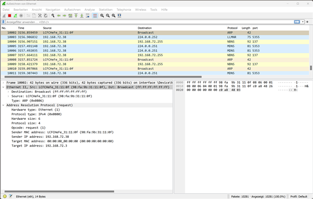

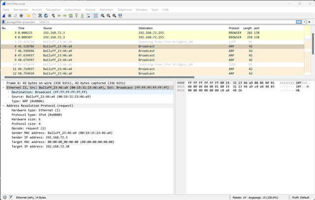

I have been working with the AM2434 CPU in conjunction with the "AM243x MCU+ SDK 08.06.00" for my networking project. Specifically, I am using the "Enet Layer 2 CPSW SWITCH Example" from the SDK. In my setup, I have connected cpsw port 1 as a MAC to MAC connection, and cpsw port 2 is connected via the PHY dp83869.
While monitoring the network traffic using Wireshark, I have noticed that only ARP broadcast packets are being forwarded. I would like to understand the reason behind this behavior and if there is any configuration or limitation that might be causing it.
I have verified that the CPSW_CUTTHRU feature is enabled in the SDK test example. However, it seems that only ARP broadcast packets are being forwarded, and other types of packets are not being processed.
