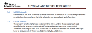

Question 1: As per ADC manual, All adc interrupts needs to be suspended in the critical section.
when we suspended all the interrupts inside ADC exclusive area, ADC Interrupts are also not getting triggered.
we found in the Adc.c that ADC Start group conversion is happening inside the critical area and we suspended in the configuration as well.
 Is it because of the disabling of interrupts inside critical area? Could you please suggest how to implement critical area for ADC?

  • Hi
    The ADC source code itself looks weird. Because the MCAL's exclusive area implementation is simply disabling "Global interrupts" by writing 1 to the IRQ bit in the CPSR register. So, if ADC interrupts are triggered inside the critical section that's a problem in interrupt mode.
    When we modified exclusive area implementation as NONE, that means no interrupts are disabled or enabled, that time ADC interrupts are getting triggered.
    I guess my above explanation explains why interrupts are getting triggered when implementation is chosen as NONE.

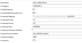

    We would like to know, whether CAT1 or CAT2 ISR is used. If CAT2, we would like to know how the ISR implementation is done.
  • Question 1 ==>we tried with disabling the interrupt which is configured in the OS for ADC. in that time also we are not getting any interrupts.
    I will check the values in the given register and come back.
    Question 2 ==> we configured CAT2 interrupt. In OS we configured interrupt with source number 147 and gave special function name as implemented in the Adc_Irq.c.  we get call to the group notification function configured in Adc from ISR handler in Adc_Irq.c.
