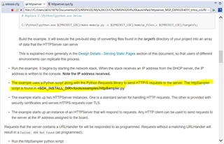

    Please also review the README.html for running this example. According to README.html, this example is designed to run with the Python script running on the client side. Did you have a chance to run the example as such? Does it work for you in HTTP and HTTPS this way?

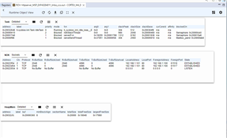

  • Can you see the ROV panel in CCS, for the TI RTOS build - this can be really handy tool for these problems.
    Look at the task view, detailed option. Check each task stack size and max usage. Does any task show as running after each refresh - most of the time for most applications is spent in idle so, if you catch a task running, it is suspicious that it is the one that is stuck.
    If you suspend debug, where is the program counter. If it is on a line with a comment "spin here forever", you have probably hit an assert and the ROV task view call stack option may give a clue about which hole it went down to die.

  • Hi Jim,
    I've tried increasing the stack size, as well as the size of various NDK buffers. However, the JPEG image still doesn't load over HTTPS. Here's a screenshot of the ROV output. I don't see anything that's obviously wrong.

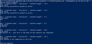

    I run the example as is. Please see below outputs for both HTTP and HTTPS. I don't see an issue.
    HTTP without -s switch:
    HTTPS with -s switch:
    Please refer to Serving Static Pages in README.html. If you are going to change the static web pages (e.g. creating your own web pages), you would need to use make-memzip.py to convert the web pages into an C array memzip_data. memzip_data array is in memzip_files.c. This array ( which contains the web pages) is what the HTTP server will send to the client. I don't believe -u /ti_ep_logo.jpg is the right way to invoke the command. I'm not even sure what -u is for and how to use it. HTTPserver cannot dynamically send a webpage/image by reading a filesystem. Please follow the README instruction. If  ti_ep_logo.jpg is the only thing you want to send, you would first need to run make-memzip.py script to convert ti_ep_logo.jpg into a C array so that the image is stored in the flash statically after you rebuild the project.

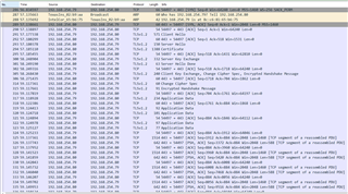

      Just to let you know that I have yet to understand the problem myself. With -s -u /ti_ep_logo.jpg, what I can see from Wireshark is that the packets are being transmitted from the server to the client but lastly the HTTP OK response is somehow not sent compared to the command without using the -s.
  • what I can see from Wireshark is that the packets are being transmitted from the server to the client but lastly the HTTP OK response is somehow not sent
    I think that may be the issue. You can also see this problem when loading the example webpage from the microcontroller. If you navigate to http://192.168.254.80, the webpage loads fine. However, the secure webpage at https://192.168.254.80 never fully loads. I can see in the Chrome developer console that the image at https://192.168.254.80/ti_ep_logo.jpg never finishes the transfer. There seems to be a software issue that causes the microcontroller to incorrectly transfer the 47KB ti_ep_logo.jpg file with HTTPS. Perhaps the large size of the image is the problem?

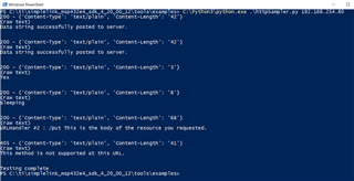

      Yes, it looks like it has something to do with the size of the image. I tried to replace  ti_ep_logo.jpg with a smaller image. I used the same subdir/ti.jpg for ti_ep_logo.jpg. As you can see it works for https. However, I don't know what knobs to turn to make it work when the image is larger. I'm also puzzled as to why without -u /ti_ep_logo.jpg, it will work.
    Using command line:  C:\Python3\python.exe .\httpSampler.py 10.219.14.160 -s -u /ti_ep_logo.jpg
