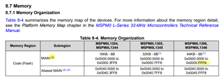

MSPM0L1306: Cannot access flash address 0xfff8 to 0xFFFF
Part Number: MSPM0L1306
Other Parts Discussed in Thread: UNIFLASH, TIGER
I remember that there is a limitation of the CPU accessible address range but don't remember which document said this. Do you know which document says that the last flash word (8bytes) is inaccessible with which reason?
