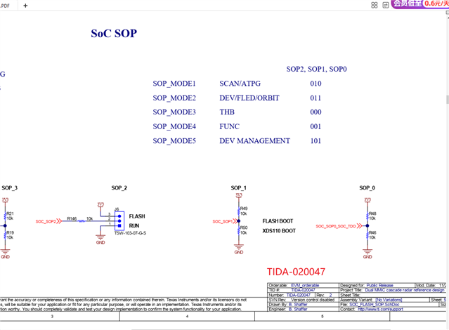

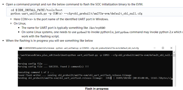

Hi team,
The AM2732 board was flashed with firmware. Regarding the firmware, the single core firmware of the hello_world_am273x-evm_r5fss0-0_freertos_ti-arm-clang and multicore firmware for the multi-core project ipc_notify_echo_am273x-evm_system_freertos_nortos have been tried. The firmware are hello_world_am273x-evm_r5fss0-0_freertos_ti-arm-clang.appimage and ipc_notify_echo_system.appimage, respectively. The firmware was burned successfully using the python script, but no print was printed on the serial port after the reboot.
Follow the default_sbl_null.cfg configuration and it still have no print:
And the following are the flash log and config files:
Could you help check this case? Thanks.
