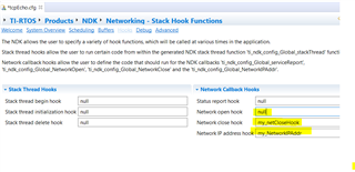

      Perhaps I wasn't clear enough. netOpenHook() is a just a callback function name. What I was showing you before and please see below image again, a hook function can be called at different time. Here, I associate a hook function called my_netCloseHook() that is only called after the connection is closed. You could also call the hook function only after the IP address is acquired. What I'm trying to say is that you can call the hook function at different stages of network. By default, if you reference the example, netOpenHook() is called right after the network is opened. You can make it null when the network is open. In your hook function, you need to somehow wait until the server is up.

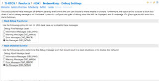

    Note that the critical threshold to shut down can also be disabled. The following code can be added to the
    configuration to disable error-related shutdowns:
    // We do not want the stack to abort on any error
    uint32_t rc = DBG_NONE;
    CfgAddEntry( hCfg, CFGTAG_OS, CFGITEM_OS_DBGABORTLEVEL,
    CFG_ADDMODE_UNIQUE, sizeof(uint32_t), (unsigned char *)&rc, 0 );
  • hello Charles,
    Thankyou for your support. But I have already tried this before and this didn't fix my issue.
    I have tried this configuration by setting from main.cfg file.

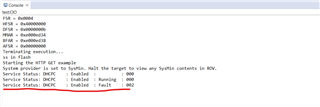

  • hey Charles,
    One more update. From the debug print in console. I found that some fault happens after a time of around 2.48 minutes from starting. This is what causes the issue. After this fault the hooks don't work and the network main stack also doesn't work.
    I think this is due to DHCP timeout. I tried some configurations in main.cfg file, but couldn't find one. Do you have any idea on how can I disable this DHCP timeout. or how can I restart from DHCP timeout?

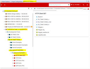

    I see in the log that you are running a HTTP GET example. If you are not getting beyond DHCP then it is a different problem from you earlier reporting. Have you tried the stock HTTP GET example from TI-RTOS?  You can download HTTP GET example from Resource Explorer from within CCS. See below. Run this example as is and see if you can get DHCP. If it works, then you can reference the .cfg. If you have the same problem acquiring DHCP IP address with the stock example then you need to look into your network and find out if there is a DHCP server on your network. You might need to contact your local IT support.

  • Hey Charles,
    Yes I was trying the HTTP Get example for TI RTOS. The console screenshot was from that example. So that means this fault does happens in the example too. Therefore I don't think this issue is due to memory management. I'm planning to restart the DHCP connection once the fault happens as it is possible to get the timeout event using 'StatusReportHook'.
