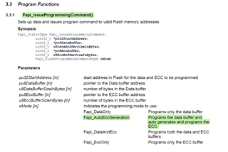

      2. When I use F021 lib to erase and write flash, will the f021 lib will generate the ecc automatically?
    Yes, it is possible.
    Actually, there are four programming modes for "Fapi_issueProgrammingCommand()" API in F021 flash library. If we select the Fapi_AutoEccGeneration, then will enable the API to be used to program the supplied data portion in Flash along with automatically generated ECC.
