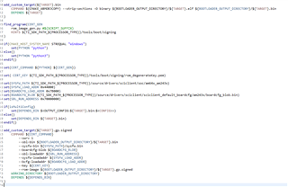

We use Cmake but here is the snippet we use for SBL-image-generation for GP-devices:

    Somehow the Cmake-Screenshot of the first post disappeared. This is our sbl-image-creation derived from the make-files:
    It's mainly the same from the make-files of the SBL_OSPI-example. Has something changed in the signing-scripts that can cause this behaviour? I checked the scripts but for the relevant parts there doesn't seem to be any changes.
