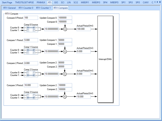

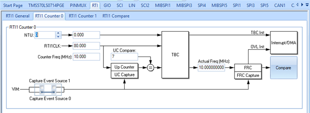

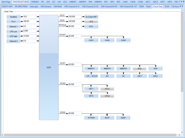

I am using a TMS570LS0714 microcontroller with a 22 MHz oscillator. I am trying to use the rtiBlinky example in HalCoGen. In HalCoGen, I have set the oscillator frequency to 22 MHz, but the period of the blinking light is 48x too slow. What could be the problem?
