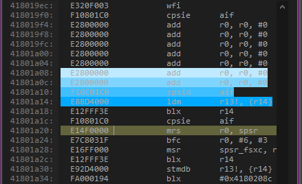

Previously, the AM2434 was booted in QSPI mode, and the boot program developed using the GD25Q16E Flash can boot up and load the running app normally on a custom board. Now replaced with the AM2431, with the same hardware, it does not boot and does not load the app.
The SBL debugger was previously written to 0x600000000 of the Flash. When debugging, the address 0x418xxxxx is entered even when the SBL program is loaded. It looks like the MCU does not recognize the boot mode settings at all? Why's this?
And read back BootMode Status(0x43000030)=0x00000d13,BootMode Config(0x43000034)=0x00000d13, indicating the boot pin representing the external configuration also does point to the QSPI Flash.

  • Hi Cherry,
    If the new chip you used is a HS-FS device, then the hs-fs version of the SBL_QSPI (SBL_OSPI, SBL_NULL) need to be flashed to the  flash and the appImage needs to be signed and re-flashed too.
    Please see the URL for details: AM243x MCU+ SDK: HS FS Migration Guide
    Ming

  • Hi Cherry,
    The new AM2431 most likely is a HS-FS device, because we have stopped the shipment of GP device. All AM243x devices since end of last year should be HS-FS devices.
    According to your description, the only change customer made is that AM2431 is used to replace the AM2434. The solution I gave above should resolve their problem.
