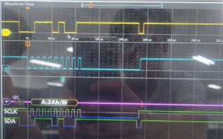

When the controller sends an I2C address, the customer board generates a NACK, and the I2C registers are shown as address values as below.
And custom board generates NACK.
When I2C operation is normal with EVM, registers and waveforms are as follows.

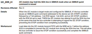

I found errata, but I don't know if this is the cause.
Can I get some examples about workaround separately from the above problem?
I don't know how to load data into the I2C module transmit FIFO with the MSB set to 1 before the address ACK is completed
