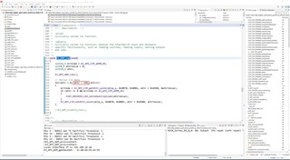

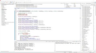

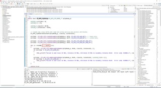

Customer use codesys and LP-AM243. They are modified the CIP Process Data Size to 256Byte, and EIP master can scan the EIP adapter. Below is they modified place.
First, they setup the size to 256 Byte in the appGenericDevice.c # EIP_cipGenerateContent().
Second, Create 256 CIP nodes in appGenericDevice.c # EI_APP_cipSetup()
Third, Read back 256 node data in EI_APP_run().
They build the modified project no error, and run this project, EIP master can scan the EIP adapter. But Uplink and downlink data are inconsistent, they work failed at this time.
