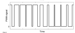

My customer is using DMA to set duty of PWM.
He needs 3ch PWM and this requires 3ch DMA.
However, MSPM0 only supports 1 full-feature channel (DMA0), supporting repeated transfer modes.
Repeated transfer mode is required to use DMA for PWM duty setting.
So the customer wants to use the three PWM duty register to alternate with the DMA0 channel.
The destination address of DMA0 rotates repeatedly in the order of PWM0, PWM1, PWM2, PWM0.

  • Hi, Sal Ye,
    My customer wants to change the duty for every cycle of PWM as follows.
    It will increase burden to generate an interrupt every cycle of PWM to change the duty.
    So, he uses DMA.
    he needs 3 channel DMA for 3 PWM channel, but the MSPM0L1304 doesn't support 3 channel DMA with repeat transfer.
    Only 1 channel supports repeat transfer.
