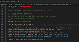

Hi Sue,
You can use our Flash API's in the MCU+SDK to access the QSPI flash. We have a QSPI Flash transfer example which does exactly what you wanted.
Flash_write --> Writes to a desired QSPI flash offset
Flash_read --> Reads the data from offset and copies to a local buffer on your RAM.
