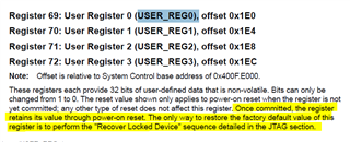

It seems that debug probe connection was not proper. Now, I'm able to perform the unlock operation.
But still, I'm unable to restore my MAC address to the factory settings. My MAC address is currently 00-00-00-00-00-00 but I want to bring it change it from this value or restore it to factory mode value, i.e., FF-FF-FF-FF-FF-FF. I'm referring to spma075.pdf for performing the unlock steps using command prompt, i.e., www.ti.com/.../spma075
Could you please suggest why is it not getting restored to factory mode value, is there anything in the schematic that we need to check for this issue? It is our prototype board.
Kiran

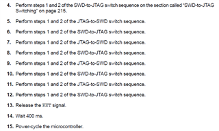

As per datasheet:
How can i send below mentioned point using programming? Please advise!!
Kiran
Hi Kiran,
That is how dbgjtag.exe will produce when you invoke it. dbgjtag.exe will instruct your debug probe (.e.g. XDS200 or LM flash programmer) to create these sequence on TCK and TMS signals. There is no need for you to create this on your own unless you must to. For example, if you don't have a debug probe like XDS200/XDS100/ICDI and if you need to unlock the device, you will create the described signal waveforms on your own. You could possibly use two GPIO pins on a 2nd device and connect these two GPIO pins to the TCK and TMS inputs of the target device (the device that needs to be unlocked) in a bit-bang method.

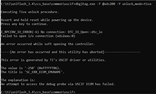

Tried the unlock in newer version of CCS, i.e., ccs1210. Following was the result.
In your screenshot you have the command wrong. It is not @xds=200. It should be @xds200
Corrected the command and this didn't unlock successfully too. MAC address is still 00-00-00-00-00-00.
Why don't you first try on another custom board that you said was working before? Need to rule out any toolchain issue. If it works for the other custom board but not your current custom board then there is something wrong your your current custom board. You can compare the TCK and TMS waveforms between each other. Having said, I don't think you can do much even if you find the waveform differences between them. If unlock operation doesn't unlock the device then I don't really see a method to erase the MAC address. The only way to erase MAC is via unlock.
