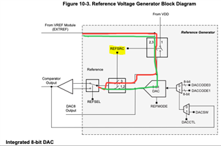

I have a customer who just wanted to confirm that in the CTL2.REFSRC register field, the option 6 is actually available on the MSPM0L1306? Does this mean that a customer can use both the internal reference to drive the reference DAC as well as using the external reference elsewhere on the MCU?
Also note that on figure 10-3 makes no mention of a REFSRC value above 3:
