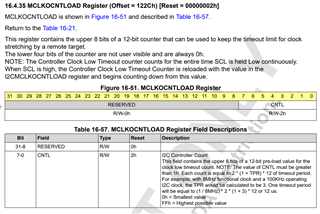

Also, in reference manual 16.2.3.6, the register name I2Cx.MCLKOCNTLOAD doesn't exist in the later I2c registers chapter. Maybe another name? (manual typo)

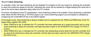

    I'm looking at the TRM now, and according to it, when in I2C Target mode, Clock stretching is always enabled.  So, what do you mean when you say "if clock stretching is enabled"?  I'm guessing if the I2C is hanging, than it may somehow be related to these TREQ or RREQ bits, when the I2C module thinks it's in the middle of a transmission/reception.
    Currently, I'm thinking we just need some sort of timeout and to re-initialize the I2C module.  If there is a timeout, we could also then set an interrupt on the PA0 edge when it's plugged in, and then know when to re-configure the I2C module.
    As for the MCLKOCNTLOAD register, it seems to be for the Controller side only.  You are correct that the register definition appears to be missing, which I believe is just a document mistake.  I'll link it below from the Pre-production datasheet for reference, and I'll follow up with my Systems team to confirm this was purely accidently and have it fixed.

    Thanks for the answer. However, I don't agree with your statement "In the target mode, clock stretching is always enabled...".
    I see in the latest TRM, the register description has that field.
    I also see following function in the most recent SDK (1.10.00.05):
    __STATIC_INLINE void DL_I2C_disableTargetClockStretching(I2C_Regs *i2c)
        i2c->SLAVE.SCTR &= ~(I2C_SCTR_SCLKSTRETCH_MASK);
    And if I invoke it to initialize the I2C, the problem disappear.

  • Hey Tiger,
    Thanks for pointing out the SCTR.SCLKSTRETCH bit.  I see the TRM should read that clock stretching is "enabled by default" instead of "always" enabled.  I've submitted that feedback already.

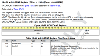

    I think in the most recent TRM, the description get mess between controller and target.
    • Keyword "timeout check" under SMBUS.
    • 16.2.3.6 Clock Low Timeout (CLKTO), register map has changes between 0.57.00.00 and 1.10.00.05. I am not sure whether IC has changed in this part, it seems the description on the TRM doesn't reflect the up-to-date SDK.
      • 0.57.00.00 I2Cx->MASTER.MCLKOCNT & I2Cx->MASTER.MCLKOCNTLOAD (same address is reserved in newer version)
      • 1.10.00.05 I2Cx->TIMEOUT_CTL & I2Cx->TIMEOUT_CNT (same address was reserved in older version)
      • If I pull the old address (reserved) on production IC & SDK, result always 0.
      • Why the registers moved out of "MASTER" register group? Does it indicate both of controller (master) and target (slave) will have this timeout feature?
