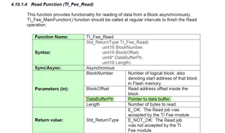

I am tryng understand the logic of writeasync in Flash EEPROM Emulation FEE.
What is the DataBufferPtr exactly ?

Hi Emre,
Pointer to data buffer.
That means for the write operation this pointer will hold the address of the buffer which consists of the data to be written. And for read operations consists of the address of the destination buffer where data need to be stored.
The above screenshots are from TI FEE user guide.
