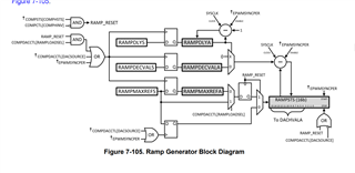

AM2634: Question regarding comparator DAC and ramp generator performance.
Part Number: AM2634
I'm currently researching the viability of the AM263x device for a peak current mode control application. However...I'm concerned with the sampling rate of the comparator DAC and the performance of the ramp generator. There does not appear to be a spec for this in the TRM or any datasheet.
What is the maximum sampling rate of the comparator DAC and ramp generator?
