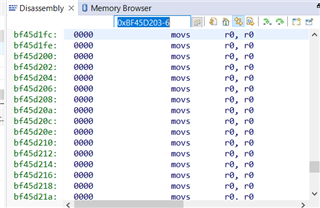

As mentioned in comment above the register R14ABT should contain address. This contained the the address in screenshot.
However this doesnt seem like a valid adress.
Is there a way to get some diagnostics after abort ? E.g. which instruction has caused this abort etc. ?
