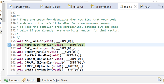

I got the firmware enter this error handler codes.

How could find which interupt caused this issue?

  • Hi Justin,
    Please insert the below into your code. Comment out any of these that you already have handlers for.
    * These are traps for debugging when you find that your code
    * ends up in the default handler for some unknown reason.
    * To keep the compiler from complaining, comment out the ones
    * below if you already have a working handler for that vector.
    void NMI_Handler(void){ __BKPT(0);}
    void HardFault_Handler(void){ __BKPT(0);}
    void SVC_Handler(void){ __BKPT(0);}
    void PendSV_Handler(void){ __BKPT(0);}
    void SysTick_Handler(void){ __BKPT(0);}
    void GROUP0_IRQHandler(void){ __BKPT(0);}

    When you run debug, you should hit one of these instead of the default handler.

  • Hi Brandon,
    Thanks.
    When my firmware receive a frame from UART0, it enters hardfault handler.
    What's meaning of hardfault?
    Thanks.
    Justin
  • Justin,
    Most typically I've seen these caused by misaligned accesses to flash memory. Have you modified your linker file at all? What are you doing with the UART data once it is received?
