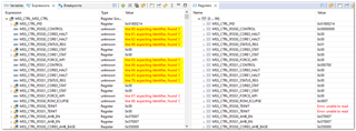

I'm using CCS 12.1 and MCU_PLUS_SDK_AM263X 8.05.00.24.
1) The memory mapped registers have all their names duplicated and concatenated. Is there a reason for that please? If not, please remove the duplication.
2) Some registers cannot be viewed in the Expressions view but they are viewable in the Register view. Looks like a scripting bug.
Thank you.

  • Hi Kier,
    I have received additional information:
    Looks like we do not support expanding register groups in the expression view because register group names are not limited to letters and digits. So, this method of checking for registers is not recommended. But for example:
    If you look at MSS_CTL_MSS_CTL, it has subgroups [0..99],[100..199]…
    So one wants to look up MSS_CTRL_PID in MSS_CTRL_MSS_CTRL in expression view, one would enter "MSS_CTRL_MSS_CTRL.[0..99].MSS_CTRL_PID," but this syntax is not supported.

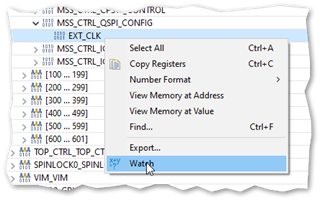

    In general, if you want to expand the whole register group, you should use the register view. If you want to watch a register or register bitfield, you should browse to the register / register bit and right click to watch.
    This will add an entry to the expression view in the supported format:
    Hope this helps clear things up.
    Daniel
    Thank you, this removes the error and I can monitor the value of the bitfields in MSS_CTRL_PID now.

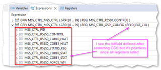

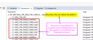

    (b) However, selecting the register and bitfield is pointless. When I expand your example, the bitfield is not isolated in the Expressions View it's still embedded in the clutter of its enclosing tree:

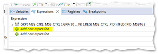

    (c) Furthermore, MSS_CTRL_PID seems to behave OK, but selecting a register further down the list seems to break the Expressions View. Take for example MSS_CTRL_QSPI_CONFIG:
    After hitting 'Watch' my selected bitfield does not appear and instead a duplicate 'Add new expression' appears:
    To partially rectify the problem, I have to close CCS and re-open. Only then do I see my newly selected bitfield name in the Expressions View. Well sort of. I still have the issue highlighted in point (b).

  • I also see issue (b). I'll follow up with engineering regarding this.

  • Regarding (b), there is some discussion regarding if this is supposed to be supported. One question is what is the use case of having it in the Expressions view vs just looking at it in the Register view. Is it for easy access and less clutter to wade through?
  • there is some discussion regarding if this is supposed to be supported.
    Which part exactly? You mean to be able to select down to the bitfield "resolution"? That's up for debate yes. Even if it didn't support bitfields, the minimum necessary would be to select the registers.
    That's right. If I need to focus on a few registers but they are sprinkled around a huge register list (that can't be listed alphabetically BTW) and I have to scroll up and down to view said registers then that is a recipe for frustration.
  • Which part exactly?
    Basically to what level of granularity is supposed to be supported.
    Makes sense. That is my experience with some of these devices with a ton of memory mapped registers defined in the Register view. It would be great if they had a way to create custom register groups and have filtering ability.
