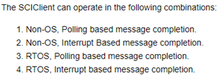

Going through the API documentation (https://software-dl.ti.com/mcu-plus-sdk/esd/AM243X/08_06_00_45/exports/docs/api_guide_am243x/group__DRV__SCICLIENT__MODULE.html) of sciclient suggests that it is possible to configure the driver to be RTOS aware and interrupt based. (https://software-dl.ti.com/mcu-plus-sdk/esd/AM243X/08_06_00_45/exports/docs/api_guide_am243x/group__SCICLIENT__HAL.html)
Looking at the source code the driver only supports polling based bare-metal operation contrary to what the documentation states. A driver which does polling inside of a critical section can have severe side-effects on RTOS based projects.
We found an implementation of the driver with server/client architecture as part of the Jacinto7 PDK. Is it planned to port this functionality also on Sitara architecture?

    First of all, apologies for the miscommunication in the user guide, we only do support polling mode in Sciclient as you have seen from the source code. This will be corrected in the upcoming release. However, implementing interrupt mode is not planned for the immediate release. The scilcient implementation in Jacinto can be confusing, although I think the interrupt mode is enabled there. The sciserver/sciclient architecture you might have seen is applicable only for the Jacinto class of devices because of the split architecture. For AM243x there is only one firmware which runs on the DMSC core to which the sciclient will talk. So there is no need for sciserver.
    Regarding the latency of polling, it actually depends on the type of request made to the SYSFW. If it is a simple enable/disable module or a version check, It is mostly in the order of microseconds. More complex requests like interrupt routing will take more time. I will see if I can get a latency table of sorts for typical requests.
