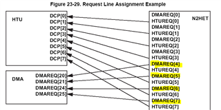

  • Hi Nuno,
    I am sorry I didn't get your point. Are you going to move the data from data field of a N2HET instruction to MCU SRAM?
    The MCU supports N2HET transfer unit (HTU) module which is similar to the DMA module. The HTU is specialized to transfer N2HET data to or from
    the microcontroller RAM.
    The HTU request is generated by the N2HET instruction, for example

  • You use NHET to generate PWM signals, right? The HALCoGen generates the code in opcode mode which is copied to NHET RAM in hetInit():
    https://www.ti.com/lit/an/spna217/spna217.pdf?ts=1691643144831&ref_url=https%253A%252F%252Fwww.google.com%252F
    The example in this appnot uses HTU to transfer data.

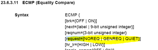

  • Can´t i just generate the pwm with a CNT instruction and a ECMP instruction like this:
    L00 CNT { next=L01,reg=A,max=8,data=0};
    L01 ECMP { next=L00,reqnum=6,request=GENREQ,hr_lr=HIGH,en_pin_action=ON,cond_addr=L00,pin=6,action=PULSEHI,reg=A,irq=OFF,data=4,hr_data=60};
    Doesnt this trigger a HW request? i though it would
  • HI Nuno,
    Yes, you can use CNT and ECMP for PWM generation. If a different PWM duty-cycle is required, the host CPU or HTU has to modify the data field of ECMP. You may know that changing the data field of ECMP directly can lead a missing pulse.
    To avoid this, MOV32 or MOV64 is recommended to update the data field and/or control field of the ECMP instruction. The MOV32 or MOV64 is only executed when the compare of the ECMP matches. The host CPU or HTU can update the next compare value by writing asynchronously to the data field of the MOV32  or MOV64 instruction instead of writing directly to the data field of the ECMP instruction.
    MOV32 is used to modify the data field of other instruction, but MOV64 can modify the data field and control field of other instructions.
    Please refer to the example in the link I gave you:

  • Hi Nuno,
    Yes, you can enable the DMA request and define the request line in ECMP. The code in spna217 is a good example of using HTU.
  • In the code spna217 they use HTU. I'm trying to use DMA but i think im missing some initializations. i have a CNT and an ECMP. when ECMP compare matches it generates a request through channel 6. this is the main.c

       One N2HET instruction can select one of 8 request lines by programming the “reqnum”, the reqnum=6 is used in this example:
        ECMP { reqnum=6,request=GENREQ,en_pin_action=ON,pin=8,action=PULSELO,reg=A,irq=ON,data=5,hr_data=0};

  • You can not use REQNUM=0 to generate a DMA request.
    To generate a DMA request, the reqnum must be 4, or 5, or 6, or 7:
    Please refer to TRM: N2HET Requests to DMA and HTU
  • I use REQNUM= 6, REQ=24 and CH=0
