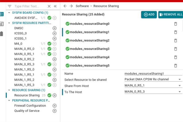

Hello Experts,
i'm trying to use the CPSW LWIP example on the HSFS Evaluation Board with SDK Version 08.06.00.43. It is working fine for Core 0-0 but on the Core 0-1 Version i always get the error that the UDMA RX Channel open failed. The specific code line is 1026 in cpsw.c: hCpsw->hRxRsvdFlow != NULL.
Could you help me figure out why this example won't run?

  • Hi Robin,
    Please refer to https://software-dl.ti.com/mcu-plus-sdk/esd/AM243X/latest/exports/docs/api_guide_am243x/RESOURCE_ALLOCATION_GUIDE.html to know on how to open Resource Manager tool.
    We want to change CPSW TX and Rx Channels sharing between MAIN_0_R5_1 (R5F0_0 non-secure) and MAIN_0_R5_3 (R5F0_1 non-secure).
    In the tool,
    1. Go to MAIN_0_R5_0 : set CPSW Tx Ch Count = 0 and CPSW Rx Ch Count = 0.
    2. Go to MAIN_0_R5_1 : set CPSW Tx Ch Count = 9 and CPSW Rx Ch Count = 1.

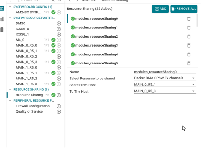

    3. Go to 'Resource Sharing' :
    - Change modules_resourceSharing0 as :
    - Change modules_resourceSharing1 as :
    4. Close Resource Manager Tool. Rebuild SBL as per steps mentioned here.
    5. Change board boot mode to UART boot mode and upload the newly build SBL to board as per the instructions mentioned in 'Flash SOC Initialization Binary'.
    6. Change board boot mode back to normal application load mode (either QSPI or NO_BOOT MODE) Recompile the example and rerun the example.
    Hope this helps. Let me know if you face any issues.
    With regards,
    Pradeep
  • Hello Pradeep,
    thank you for your instructions. I did as you said (only on step 2 i could only give 8 tx channels to main_0_1).
    I am getting different errors now, can you help me figure out a fix? Maybe there is more ressource allocation change necessary for the udma ring.
    edit: I changed the rings for cpsw tx and rx channel aswell and now it's working, thanks for your help
