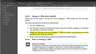

  • We are trying to configure the Category 1 interrupt and following the vector OS document. for the category 1 ISR the mentioned some following sequence, we can do 1,2 and 4 points as per the below snippet. but we are struggling in 3rd step to enable the interrupt of category 1ISRs by directly manipulation the control registers in the interrupt controller.

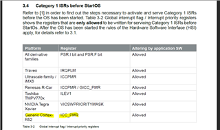

  • Global interrupt flag/ interrupt priority register, we trying to locate in the technical reference document. but cannot locate. Could you please clarify and guide as to activate CAT 1 ISR? thanks

  • Hi Sunil,
    Yes, we have option.
    Let's assume GPT module, we have 5 interrupts, 4`s have CAT-2 interrupts and 1 alone CAT-1 In this situation from my understanding in EB we have a one option correct. how it is possible for different channels CAT-2 and CAT-1?
    If we changed the value option via Vector DaVinci configurator, then the vector mentioned some sequences, as I mentioned in previous comments. highlighted below.
                     Enable the Interrupt sources of category 1 ISRs by directly manipulating the control
    Could you please guide us without sys_vim library how to enable the Interrupt sources of category 1 ISRs and FIQ by directly manipulating the control registers in the interrupt controller.? If we have sample code for this, please share with us.
    Note: We are not using the sys_vim library for Enable the Interrupt sources of category 1 ISRs by directly manipulating the control registers in the interrupt controller
    Vivek Arivazhagan
  • Hi Vivek,
    In MCAL We do not have per hardware instance interrupt CAT support but it is module level.
    Thanks And Regards,
    Sunil Kumar M S
