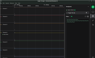

  • Hi Charles,
    I got a logic analyzer and tried to read in PC4 after connecting to the Tx pin of my ESP32 and I am able to read the data sent from ESP. However, when I open serial monitor connected to UART0, no data is shown. I have attached logic analyzer output. Please suggest if anything'slogic analyzer output wrong with my code or otherwise.
      First of all, you don't show label for what each channel is on the logic analyzer capture? So which channel is UART0TX, UART0RX, UART4TX and UART4RX. Secondly, they are all flat line, no activities as far as these waveforms are showing. You either need to zoom out or this is actually what is received on UART4RX. If that is the case, as far as Tiva MCU, it does not receive any data.

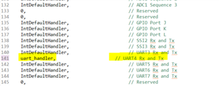

    - Show your startup_ccs.c file. Do you have uart_handler mapped to UART4 in the interrupt vector table? See below example.
  • I am using VSCode on Debian, flashing through Uniflash software. Can you please suggest based on that? I have added uart_handler against "UART4 Rx and Tx" in startup file (startup_gcc.c), and the RXRIS is not getting set.
  • You haven't answered my first question. What does UART4RX show on logic analyzer? Do you see any activities? If RXRIS bit is never set then it means it did not receive any data. RXRIS is a raw flag indicating that a character is receive. If RXIM bit in UARTIM register is set then it means the interrupt RX receive is enabled. You will also see RXMIS bit set in UARTMIS register if both RXRIS and RXIM are high.

  • Attaching logic analyzer capture for UART4 Rx pin :
      Ok, there is data on UART4RX. Can you show the full register dump for UART4 as I requested earlier?
