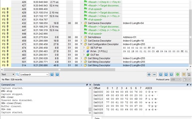

  • Hi Charles,
    So I think I've finally found the root cause of my issue.  It looks like there is an "instruction access violation" BIT 0 in register HFAULTSTAT that happens when I change the #define APP_BASE from 0 to 0x02800.  I initially thought this was a bootloading problem.
    I'll be troubleshooting this now as my problem is due to a fault that happens because I change my APP_BASE.  I'll attach the fault info in case you happen to have run into this before.  My PC register becomes 0xFFFFFFFE and my LR becomes 0xFFFFFFF1 which I'm not too sure what to make of yet.  My stack pointer points to a value in the middle of my 1024 byte stack and shows an address of 0x200032F0.
    It seems as though changing APP_BASE does affect something else as this project works fine when APP_BASE = 0, but not when 0x02800.

  • Hey Charles,
    So it looks like after some work this weekend the CPU fault was due to the project settings - specifically not resetting the MCU on program load or restart.  Once I checked this box in my application project debug settings I am now able to load both the bootloader and my application project successfully.  So a little bit of a curve ball due to project settings.  I guess there was some old register settings somewhere not being reset when I was loading my application project.
    With this issue solved, I'm back to trying to get the flash bootloader working with USB.  With the following settings I don't see the device enumerate correctly.  Do you see anything wrong with my bl_config.h file?
    I've followed your advice and used the "boot_serial" application and attempted to change it over to be a usb bootloader instead of serial.  I think I am close however the bootloader doesn't fully enumerate as a DFU device.  It seems to get stuck.  My guess is there is a configuration problem, but I'm not seeing it.
    Also, should my bootloader launch code look like the boot_demo2 project - code shown below?  I ask because when I use this it doesn't work - unless there is an issue with bl_config.h.  I guess that could be causing this issue too.

    I also see the traffic getting stuck in my usb protocol analyzer.
    All of this information is the same if I just run the bl_flash bootloader program.  Just configuring bl_config.h and programming the launchpad - I see the failure to load the DFU device in device manager and this is all the information so it really doesn't have anything to do with my application.  If I tell my application to trigger the bootloader I get the same issue.
    I am happy to report CCS works fine with both projects loading/erasing etc...now that they are properly configured so thank you!

  • Hi Charles,
    Thank you for the response! I think I am now up and running and my issue was actually another test setup issue.  The vid/pid I was using had some problem associated with it due to a previously failed enumeration attempt.  I usually can manually clear the registry info so this doesn't happen.  I successfully cleared the registry info for the composite device I'm working on for each enumeration and had no issues.  For some reason with the DFU though this doesn't work.  Using the same process the bootloader still fails to enumerate.
    It looks like changing the VID allowed me to solve this problem.  I need to work on figuring out what residual data needs to be cleared in the registry so I can use the default vid/pid in the example.
    I will still pull down that project zip you attached and do a diff to see what differences might existing but for now it looks like I'm up and running with the flash bootloader.
    There isn't anyone in your group that happens to know what to clear in the registry so you get a fresh enumeration with the same vid/pid is there?
  • The vid/pid I was using had some problem associated with it due to a previously failed enumeration attempt.  I usually can manually clear the registry info so this doesn't happen.
