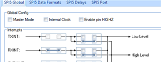

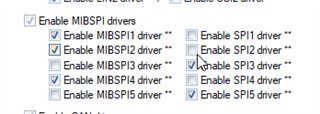

I am trying to use the SPI5 RX interrupt in Halcogen/CCS project,
SPI 5 is not in MibSPi mode:

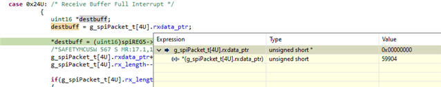

The interrupt routine is called:
Here the programm crashes because it makes use of a NULL pointer. This seems to be related to MibSpi, why is that invalid code generated and called?
I attached to project if it helps.

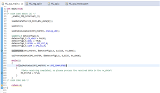

    If you enable the SPI rx interrupt, then before sending data you should call and initialize the destination buffer using the "spiGetData" function.
    For example, you can see the below code:
    In this code i just called "spiGetData" function and initialized the destination buffer and block size to be received.
    Once you did this you can call the "SpiRxStatus" function to check the receive status.
    I am attaching my example code here, please take it as reference and do the necessary modifications.
    SPI_Rx_Interrupt_Test_LC4357.zip
    Thanks & regards,
    Jagadish.
