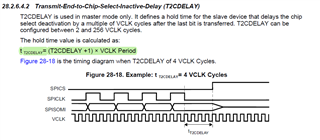

What about the max f(vclk)? I believe we need that for CS active setup and hold times. Hope we can make the C2TDELAY and T2CDELAY programmed even the values for 0 so that it depends only on tc(vclk) as per the timing requirements. Any recommended documentation for reference?
Here are the formula's for C2TDELAY and T2CDELAY
So as mentioned in above formula's, the min value of t C2TDELAY is 2*Vclk if the C2TDELAY =0 and min value of t T2CDELAY= 1*Vclk if the T2CDELAY =0 .
