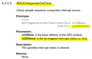

    You wrote the below code. You are supposed to provide the bit-mapped interrupts status to clear, not ADC_SEQUENCE_NUMBER which is 3 all the time. Please refer to peripheral driverlib user's guide.
    ADCComparatorIntClear(ADC0_BASE, ADC_SEQUENCE_NUMBER);

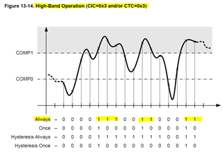

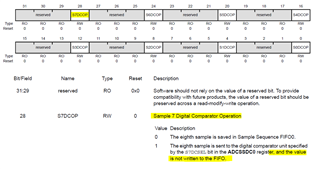

    I think in your case it should be ok to enable both  both DCONSS3 and MASK3 bits in ADCIM register. The reason is that you are routing the input value to the digital comparator. The input value will not be saved in the FIFO. In your ISR, you should not expect to read the ADC value but instead check if DCONSS3 is set. If it is set, it means the upper threshold is detected.
    If both bit 3 and 19 are set then it means it detects that your input channel is higher than COMP1 threshold.

      ADC_SSOP3: 0x1 -> connect ADC output to comparator
      ADC_SSDP3: 0x07 -> connect to comparator 7

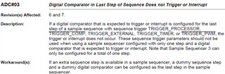

      Please refer to the below two errata and apply the workarounds.
  • Hi Charles,
      Thanks for your quick response, I think these are what we need.
