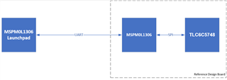

Context:
I am working on a reference design that involves pushing data from a launchpad to a reference design board using UART. The MSPM0L on the board will then send this data to the TLC6C5748-Q1 via SPI. I am creating code for the MSPM0L1306 on the board.
Code for the SPI transactions between the MSPM0L1306 and TLC6C5748 is implemented in the project (it is based on the spi_controller_multibyte_fifo_dma_interrupts example), but code for UART event handling is missing.
Since I am new to both UART and SPI, I opted to create a simple test setup using two launchpads to create code that handles both UART and SPI communication. I am using the spi_controller_multibyte_fifo_dma_interrupts &  spi_peripheral_multibyte_fifo_dma_interrupts example, and adding some code from the uart_rw_multibyte_fifo_poll example. I can confirm that all the examples work for me. Overall, here are the conditions I expect for a successful test:
1) Peripheral sends a message via UART to controller.
2) Controller receives message. Controller replaces contents of gTxPacket with the uART message.
3) Controller & Peripheral fill up their TXFIFO.
4) Controller begins SPI transaction, and the same steps as the multibyte_fifo example occur.

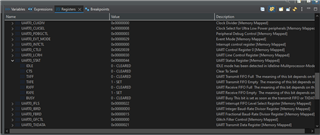

Problem:
I am having trouble adding code to support the UART interface. When I run my code to test step 1, the Peripheral TX line stays low. It won't go high again even after resetting both launchpads. The only way to reset it is to power-cycle the boards.
When I disconnect TX and RX between the launchpads, I see the correct UART Message.
Can you provide guidance on how to go about fixing this? I suspect that it is either something with spi_controller_multibyte_fifo_dma_interrupts or sysconfig setup. Here is my code:

    How are you configuring the UART pin on the RX side and what pin are you using? It seems like it might be holding the TX line low for some reason. Really it shouldn't act on that line beyond sampling it.
    Brandon Fisher
  • Hey Brandon,
    For both projects, Pin 22 is UART0.RX and Pin 21 is UART0.TX. For my test, I tie Peripheral TX with Controller RX, and Controller TX with Peripheral RX.

    When you get stuck on line 79, what is the value in the UART0_STAT register? You can check this in CCS if you go to View-> Registers while debugging.
    Brandon Fisher
  • Hey Brandon,
    I was unable to reproduce this error when both boards are connected, but when they are disconnected, I found that connecting TX for the peripheral will fix this.
