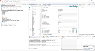

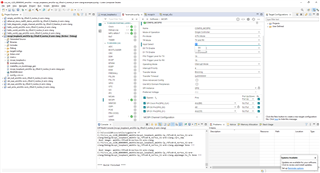

    The mcspi_loopback example in mcu_plus_sdk_am243x_08_06_00_45 is only an example program to show the customer how the MCSPI works easily. It uses the internal loopback which receives what it sends by define the Input Select as D0 (which is also the TX pin) in syscfg. Ultimately it is a SPI Controller example.
    If you want to exchange data between two AM243x LPs, you will need to connect two LPs using blue wires (LP1:D0 <--> LP2:D1, LP1:D1 <-> LP2:D0, LP1:CLK <--> LP2:CLK, LP1:CS <-> LP2:CS). Input Select should be changed to D1 in syscfg for the MCSPI controller. The MCSPI_transfer will either TX only or TX and RX at the same time according to the TR Mode in syscfg. Most of the time, you want set to TX and RX mode, in that case, the TX and RX happen at the same time. If you are sending data only this time, just ignore what is in the RX buffer. If you are receiving data only, just put garbage data in TX buffer, because in the MCSPI protocol, the MCSPI controller is always the clock provider and transaction initiator.
    For the program runs on the MCSPI peripheral, you will need to change the Mode of Operation to Single Peripheral
    Once your syscfg file is set up properly, the MCSPI instance open will be handled by the Drivers_open() automatically.
