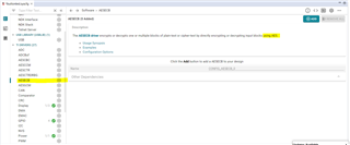

Do the TI drivers such as C:\ti\simplelink_msp432e4_sdk_4_20_00_12\source\ti\drivers\aesecb use hardware acceleration?  I don't see the module initialization as in driverlib.
-Mike
  • Hi Mike,

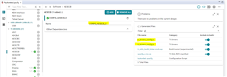

      I will investigate and get back. I tend to think it uses the AES modules as stated in sysconfig description. After AESECB is added, the generated file ti_drivers_config.c and ti_drivers_config.h files are updated.
    In the meantime, here is the user's guide for AESECB. https://software-dl.ti.com/simplelink/esd/simplelink_msp432e4_sdk/3.40.00.08/docs/tidrivers/doxygen/html/_a_e_s_e_c_b_8h.html#a4f4274c6aa928e8e10d3e516e73f77ea
