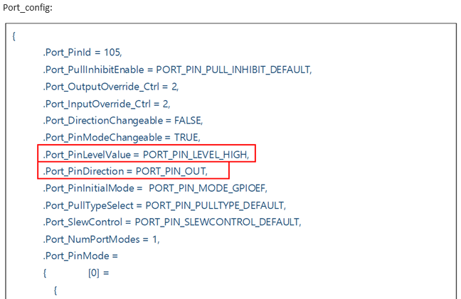

    Port_config:
             .Port_PinId = 105,
             .Port_PullInhibitEnable = PORT_PIN_PULL_INHIBIT_DEFAULT,
             .Port_OutputOverride_Ctrl = 2,
             .Port_InputOverride_Ctrl = 2,
             .Port_DirectionChangeable = FALSE,
             .Port_PinModeChangeable = TRUE,
             .Port_PinLevelValue = PORT_PIN_LEVEL_HIGH,
             .Port_PinDirection = PORT_PIN_OUT,
             .Port_PinInitialMode =  PORT_PIN_MODE_GPIOEF,
             .Port_PullTypeSelect = PORT_PIN_PULLTYPE_DEFAULT,
             .Port_SlewControl = PORT_PIN_SLEWCONTROL_DEFAULT,
             .Port_NumPortModes = 1,
             .Port_PinMode =
             {            [0] =
                    .mode = PORT_PIN_MODE_GPIOEF,
                    .muxmode = 7,
             .Port_PinDioRegId = (3 - 1U), /* GPIO register index is 0 based */
             .Port_PinDioChannelId = 6,
             .Port_RegOffsetAddr = PINK3_EPWM13_B,
             .Port_PinSignalName = (const sint8 *)"GPIOEF_70",
             .Port_PinName        = (const sint8 *)"PIN_K3",
             .Port_PinSetEdgeTrigger = FALSE,
             .Port_PinSelectEdgeTrigger = PORT_RISING_EDGE,

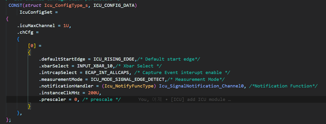

    Icu_config:
    /* Icu Channel Configuration parameters */
    CONST(struct Icu_ConfigType_s, ICU_CONFIG_DATA)
         IcuConfigSet =
        .icuMaxChannel = 1U,
        .chCfg =
            [0] =
                .defaultStartEdge = ICU_RISING_EDGE,/* Default start edge*/
                .xbarSelect = INPUT_XBAR_0,/* Xbar Select */
                .intrcapSelect =  ECAP_INT_ALLCAPS, /* Capture Event interupt enable */
                .measurementMode = ICU_MODE_SIGNAL_EDGE_DETECT,/* Measurement Mode*/
                .notificationHandler = (Icu_NotifyFuncType) Icu_SignalNotification_Channel1, /*Notification Function*/
                .instanceClkMHz = 200U,
                .prescaler = 0, /* prescale */
    Here we are using xbar_0 .But can be used anything.

  • Hi Mudit Bhansali,
    Could you please provide more details on below Port_PinLevelValue and Port_PinDirection of 'Port_config' ?
    What does mean of 'PORT_PIN_OUT' in below?
    Thanks and Best Regards,
    SI.
  • Hi SI,
    Port Pin direction is used to signify that ok that GPIO should be used for output purpose or input purpose.
    Port Pin level value signifies the voltage level of a pin.
    Thanks for your response.
    Then, for their usecase - To detect rising edge in GPIO input, customer should set as below, right?
                .Port_PinDirection = PORT_PIN_IN,
    And, when they want to detect rising edge in GPIO output, customer should set as below, right?
    What confused here is that 'Port_PinDirection' is not 'Port_PinDirection' of ICU module. You meant is it is PinDrection of GPIO, right?
    SI.
  • Hi SI,
    So here since calculation is done by ICU module and GPIO input is provided to ICU with help of X-Bar. So, customer should always set the Pin_Direction as Pin_out ,since they are transmitting the wave to ICU.
    Hope this clear your confusion.
  • HI Mudit Bhansali,
    I'm sorry, but I'm still cofused.
    What I ask is the port setting of ICU and Pin_Direction of ICU module.
    Could you please clarify on the Port_Pin_Direction of ICU module? Should it be set as Pin_out?
    SI.
  • No , For ICU module it will be Port_In But on the other hand for GPIO it will be Pin_out.
    Mudit
  • Mudit,
    Oh. Then the port config you mentioned in above is for GPIO port, not ICU. Is there any required port config for ICU in this usecase(detecting GPIO rising edge)?
    SI.
  • Yup, The code snippit which i had shared is for GPIO port configuration.
    For ICU , the port config is default only, which we are providing in recommended configuration of port.
    Mudit
