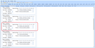

I am using this processor and i have a problem with OTP memory space.
In the processor manual, the Customer-OTP field consists of 3 Banks.

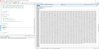

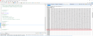

Actual sizes of Bank0 and Bank1 appear to be 4KB. But when I check these Banks from memory map or Uniflash on the IDE, the fields after 3KB are replaced by "?????" instead of "FFFFF". it seems.
And when I hover over it, I see a warning like "target can not read the device".
The visible area in both benches is 3Kb.
Can you tell me why the next 1 KB is showing as a question mark, why we can't access it and how can I access it?
