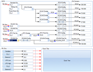

    This is our GCM HalCoGen Setup in our test environment:
    VCLKA4 Src: PLL2 100 MHz
    VCLKA4_DIV 12.5 MHz
    VCLA4_S 100 MHz
    The EMAC still works perfectly fine with this setting, although VCLKA4_DIV = 12.5 MHz, why ?

    Changing GCM in HalCoGen setup (our standard setup):
    VCLKA4_DIV 25 MHz
    VCLA4_S 100 MHz
    The EMAC still works perfectly fine with this setting.

    Anaother changing GCM in HalCoGen setup:
    VCLKA4 Src: VCLK 75 MHz
    VCLKA4_DIV 37.5 MHz
    VCLA4_S 75 MHz
    The EMAC still works also perfectly fine with this setting,
