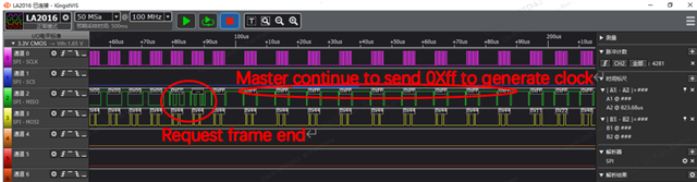

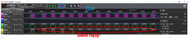

    The host sends a request frame: (note:   channel0:  SPI CLOCK     channel1: CS(unused)   channel2: Master device    channel3: slave device)
    0xAA  0xBB  0x06  0x02  0x00  0x00  0x00  0x00  0x00  0x00  0x00  0x00  0xCC  0xDD
    After sending the request frame, the host continues to send 0xFF to  generate the SCLK signal(0XFF is what I call a virtual signal)
    Slave replies data to master

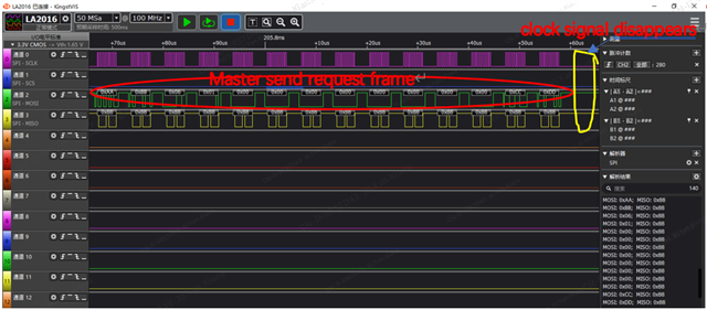

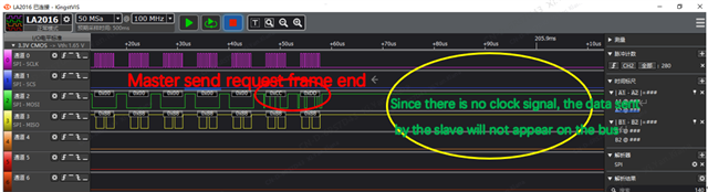

    Case 2 :After I tried the host to send a request frame, the host does not continue to send 0XFF,and the waveform is as follows:
    Since there is no clock signal, the data sent by the slave will not appear on the bus

      Thank you for your waveform captures. Can you tell me what triggers your code to send 0xFF on the master side? Is it based on what is received from the slave?
      If you look at case 1, while you are sending 0xAA  0xBB  0x06  0x02  0x00  0x00  0x00  0x00  0x00  0x00  0x00  0x00  0xCC  0xDD, you are receiving 0x44, 0x44.....0x44 from the slave? Is this what you are expecting to receive?
      If you look at case 2, while you are sending 0xAA  0xBB  0x06  0x02  0x00  0x00  0x00  0x00  0x00  0x00  0x00  0x00  0xCC  0xDD, you are receiving 0x88, 0x88....0x88 which is different from case 1. Is possible that on the master side, if it receives non-0x44 then it will not send out the virtual clocks with 0xFF? It looks like there is a one-bit shift between 0x44 and 0x88. You will need to investigate this. Please make sure both sides have identical baudrate. Check if there is any noise on the bus as the noise may cause the slave to misinterpret as a valid clock. When this happens, it sends the data too early resulting in a shift. You will need to use a oscilloscope to see this.  I will suggest you focus on the first character you send. In case 1, when you send 0xAA on the master request frame, you are receiving 0x44 (01000100b). In case 2, you are receiving 0x88 (10001000b). Find out why there is a one bit shift.
