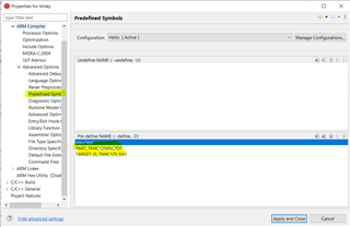

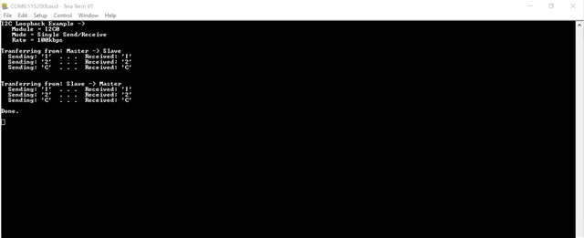

HI TEAM
I am trying to up the I2C0 in the TM4C1294 EVK , but I2C master clock is not working , I have use the demo  code (master_slave_loopback.c) provided by TI SDK , can you please help me to up the I2C clock
pull up is given from the I2C slave to the EVK I2C master, so there is no problem in pull up
PFA of the code I used for testing , please suggest us what need to done from software or hardware side to fix the I2C clock issue.
Basically the code i have taken is form SDK provided by TI for TIVA series
please response

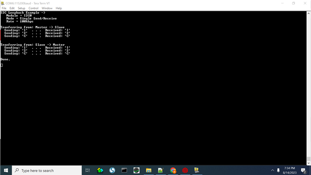

  • This is the same example I run on EK-TM4C1294XL LaunchPad. Below is the terminal output.
    What do you see on the terminal output?
    When you said you run EVK board, do you mean you run on EK-TM4C1294XL board?
    I also want to make sure in your project property, you are NOT selecting a TM4C123 device. Below is selecting TM4C129.
  • this is the print iam getting
    yes i run on  EK-TM4C1294XL board only

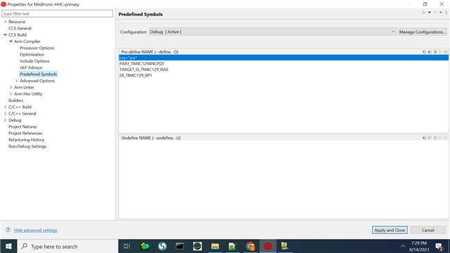

    this is my predefined symbols settings
    please correct me any changes need to be done
  • can you also tell the difference between RA0 and RA1 etc...

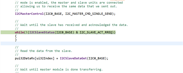

  • After this terminal output program gets aborted
    getting into the error here and aborted
    please help to resolve the issue

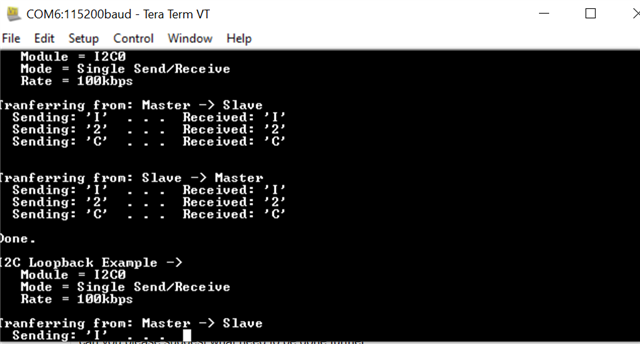

  • Your code is running normal. The reason in mine, I put a while(1) to repeat the I2C transactions. If I were to remove the while(1) to repeat the transactions, I would have also exited to abort() which is absolutely normal. main() is no different from any other function from C language stand point of view. When it finishes the last line of code in main() it needs to go somewhere and it just go abort routine. In a real application, you would not have the program exited main().
     Refer to this link about return(0) from main().
    https://www.tutorialspoint.com/What-should-main-return-in-C-and-Cplusplus#:~:text=The%20return%20value%20for%20main,non%2Dzero%20codes%20are%20interpreted.

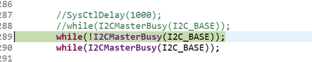

  • I tried to run inside while but it get struck here after first set of data transmitted and could not able to transmit  data second time
    can you please suggest what need to be done further
    debug log for your refernce

            pui32DataTx[0] = 'I';
            pui32DataTx[1] = '2';
            pui32DataTx[2] = 'C';
            // Initalize the receive buffer.
            for(ui32Index = 0; ui32Index < NUM_I2C_DATA; ui32Index++)
                pui32DataRx[ui32Index] = 0;
            // Indicate the direction of the data.
            UARTprintf("Tranferring from: Master -> Slave\n");
            // Send 3 peices of I2C data from the master to the slave.
                // Display the data that the I2C0 master is transferring.
                UARTprintf("  Sending: '%c'  . . .  ", pui32DataTx[ui32Index]);
                // Place the data to be sent in the data register
                I2CMasterDataPut(I2C_BASE, pui32DataTx[ui32Index]);
                // Initiate send of data from the master.  Since the loopback
                // mode is enabled, the master and slave units are connected
                // allowing us to receive the same data that we sent out.
                I2CMasterControl(I2C_BASE, I2C_MASTER_CMD_SINGLE_SEND);
                // Wait until the slave has received and acknowledged the data.
                while(!(I2CSlaveStatus(I2C_BASE) & I2C_SLAVE_ACT_RREQ))
                // Read the data from the slave.
                pui32DataRx[ui32Index] = I2CSlaveDataGet(I2C_BASE);
                // Wait until master module is done transferring.
                while(I2CMasterBusy(I2C_BASE))
                // Display the data that the slave has received.
                UARTprintf("Received: '%c'\n", pui32DataRx[ui32Index]);
            // Reset receive buffer.
            UARTprintf("\n\nTranferring from: Slave -> Master\n");
            // Modifiy the data direction to true, so that seeing the address will
            // indicate that the I2C Master is initiating a read from the slave.
            I2CMasterSlaveAddrSet(I2C_BASE, SLAVE_ADDRESS, true);
                // Display the data that I2C0 slave module is transferring.
                // Tell the master to read data.
                I2CMasterControl(I2C_BASE, I2C_MASTER_CMD_SINGLE_RECEIVE);
                // Wait until the slave is done sending data.
                while(!(I2CSlaveStatus(I2C_BASE) & I2C_SLAVE_ACT_TREQ))
                I2CSlaveDataPut(I2C_BASE, pui32DataTx[ui32Index]);
                // Read the data from the master.
                pui32DataRx[ui32Index] = I2CMasterDataGet(I2C_BASE);
            // Tell the user that the test is done.
            UARTprintf("\nDone.\n\n");
            SysCtlDelay(ui32SysClock/6);
        // Return no errors
        return(0);
  • I could to able to see data transfer in I2C1 in terminal , but some times it got struck need to check why
    But when I tried to check in digital oscilloscope (DSO) with pull up (10 k resistor in I2C1 CLK  and I2C1 DATA, PG0 and PG1 pins) i could not see any wave forms  and frequency value , can you confirm that if we probe those lines we could able see I2C waveform since it is internal loopback code.
    if possible can you please share I2C waveforms using this code
  • could not able to capture 100 Kbps I2C clock waveform , any adjustments in system clock or PLL calculation need to be made in function I2CMasterInitExpClk(),
    so that will get capture clear I2C clock and data waveform
    If you are in loopback mode then you cannot see bus activities. The example I showed was for I2C0. Do you have any problem running it?

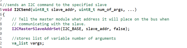

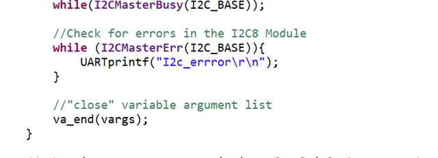

  • HI
    I am using this code but still I could not send the data in I2c  iam getting the following error
    when I tried to write first time the data is written to the slave which i could able to capture in I2c analayzer
    but when i continuously try to write the next configuration register
    iam getting I2c error
    Can you please help me to  check the code any changes to be made in the code

    void I2CSend(uint8_t slave_addr, uint8_t num_of_args, ...)
        // Tell the master module what address it will place on the bus when
        // communicating with the slave.
        I2CMasterSlaveAddrSet(I2C_BASE, slave_addr, false);
        //stores list of variable number of arguments
        va_list vargs;
        //specifies the va_list to "open" and the last fixed argument
        //so vargs knows where to start looking
        va_start(vargs, num_of_args);

            SysCtlDelay(1000);
            // Wait until MCU is done transferring.
            while(I2CMasterBusy(I2C_BASE));
            //Check for errors in the I2C8 Module
            while (I2CMasterErr(I2C_BASE)){
                UARTprintf("I2c_errror\r\n");
            //"close" variable argument list
            va_end(vargs);

    Can you at every place where you have while(I2CMasterBusy(I2C_BASE)) in your code,  add another line before it highlighted in red. Does it make a difference? Please refer to this post too. https://e2e.ti.com/support/power-management-group/power-management/f/power-management-forum/844446/tpsm846c23evm-806-why-ic2-needs-certain-delay-in-tpsm846c23evm-806-for-every-data-byte-transmission
    while(!I2CMasterBusy(I2C_BASE)); // Add this line before wherever you have the below line.
