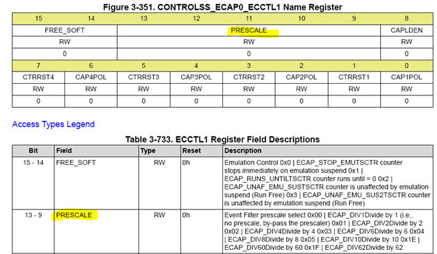

    Do you enable the event prescaler? The input signal to ECAP can be prescaled by 2~62. This feature is very useful when the input has very high frequency. If this feature is enabled and prescaler is big, you might not be able to measure the 1Hz signal.
    The prescaler is defined in ECCTL1[13:9]
