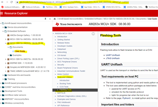

Hi Sue,
AM2634 doesn't have on-chip flash. An external flash is used on AM2634 launchpad and control card.
You can flash the application image to flash using the flashing tools in our SDK:
Hi Sue,
Here is the description about the flashing tools:
