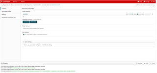

I have a question regarding the MSP432E401Y Microcontroller LaunchPad. I have already done the firmware update as described in the manual.
Then I changed the USB port and changed the jumper. As you can see in the picture.
Then I went to the BP-DAC11001EVM website and tried to connect there. However, the error message "Controller is not responding" is displayed every time.I cannot select a different Port in the Serial Port Configuration Options.The board is also not recognised in the device manager of Windows. Any idea?
Many thanks for your help.
  • Good day
      If you have already loaded the firmware acctrl.bin then there is no need to do the second image operations. Looking at your console output on the first image, the firmware acctrl.bin is already loaded successfully. I think the second image is for users who are loading the firmware for the first time. Please restore the jumper settings to its original position. You should be able to reload acctrl.bin again. I'm also attaching a very simple blinky.bin file here. Once loaded, you should see a LED on the LaunchPad board blinking.
